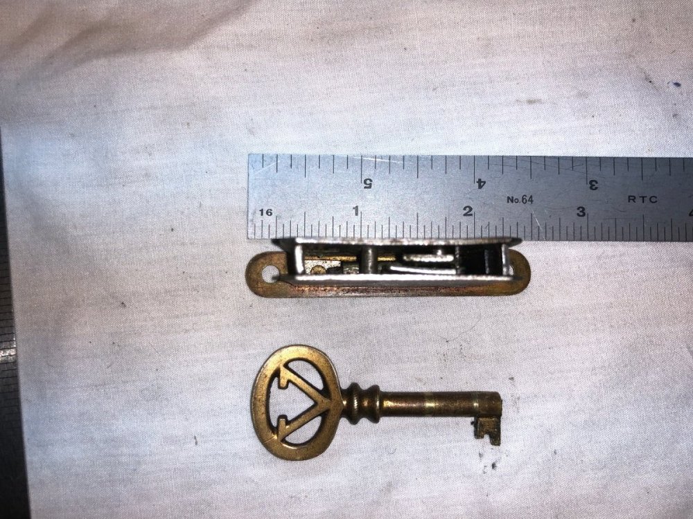

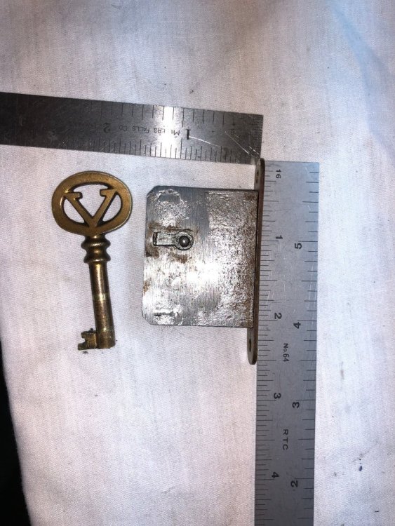

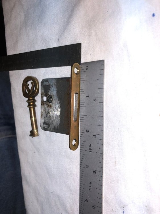

xtal_01 Posted May 1 Author Share Posted May 1 3 hours ago, CurtA said: What type key do you have? Post a pic of it. There are several different types. Hmmm ... I didn't know there was different keys! I was told they all the same. I go this key a few weeks ago. Here is a picture of the lock and key I took before putting it back into the unit. The key "almost" works ... it just does not seem high enough in the center to move the parts in the lock. Any help would be greatly appreciated! Link to comment Share on other sites More sharing options...

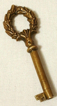

CurtA Posted May 1 Share Posted May 1 (edited) You have the later Victrola "V" key and since your phonograph is an earlier VTLA, you probably need a Victrola "wreath" key which has a different cut. They are somewhat harder to find and more expensive, so you could find a later lock that fits the key you have until you can locate a wreath key... The V key fits all later Victrolas, the wreath key doesn't. The Victrola wreath key has a shorter shaft than a wreath furniture key. Victrola keys pictured below, furniture key on right. Try contacting George Vollema - www.victroladoctor.com Edited May 1 by CurtA 1 Link to comment Share on other sites More sharing options...
Henry Posted May 1 Share Posted May 1 Just a word of warning/caution. It is well known that if the lid lock should malfunction while the lid is locked (i.e, get stuck, unable to open with key, etc.) it is impossible to open the lid non-destructively. I've started keeping the key to my VV-XI under the lid, and never locking it. While you might want to acquire the correct key for the sake of completeness, you might strongly consider never actually using it, out of regard for the risk to that beautiful L-door. 2 Link to comment Share on other sites More sharing options...
