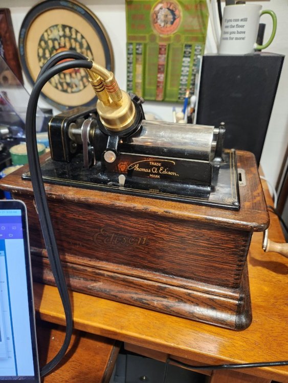

I have the Act II installed in an Edison Standard 2/4 minute machine that seems to work quite well.
Other than that, I transfer using Audacity and a preamp just like I transfer disc records. It is not as good as some of the more recent much more expensive machines to transfer cylinder records. But, it does fairly well on high quality cylinders. I think there might be some Act II reproducers out there that might be for sale. I found mine doing some searching and finally getting ahold of the original maker that had one spare he agreed to sell me.
