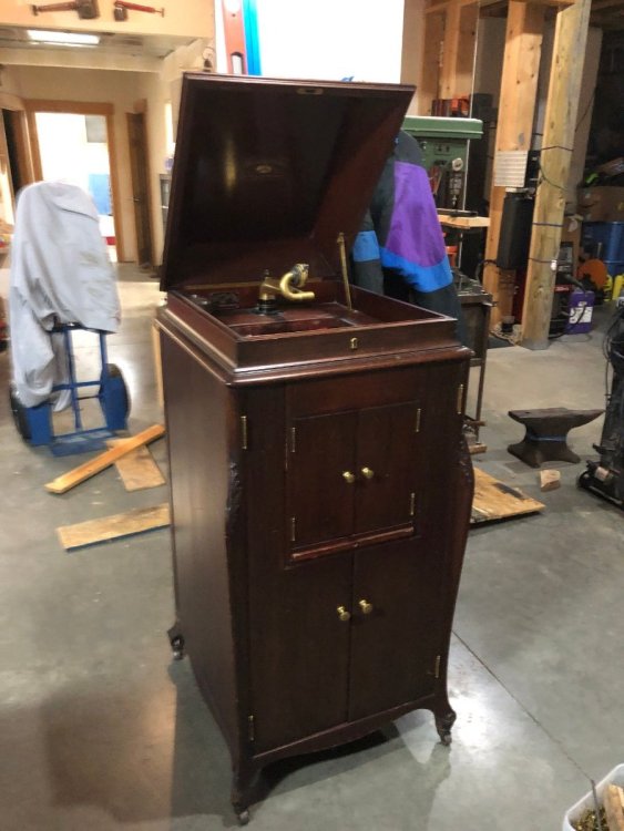

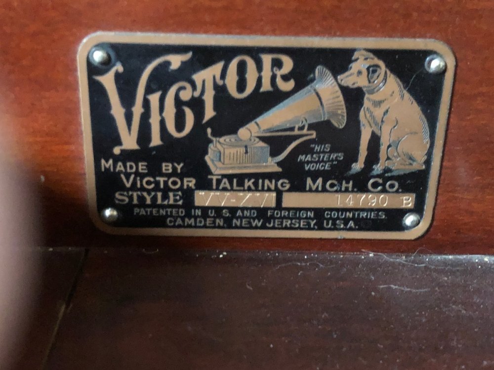

Hello,  I have 1909 VV-XVI Victrola.  It uses two screws just under the platter to hold the motor board to the case.
When I got it, there were no screws.  I got lucky, when I flipped it on it's back to make a repair, one fell out of the bottom.

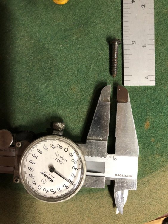

These are an odd size screw (well at least I could not find any in my junk pile).
They are a number 7  ... not the usual 6 or 8.  In fact, I was given a couple #8's and told there were came from a motor board but they are too large (shank dia .165).  I sure I could "force" them in but I would rather find the correct ones.
The shank of the body measures at .150 dia
The total length (from under the head to the end) is about 13/16
The unthreaded shank is about 1/4" long
I would like two ... but really only need one.
