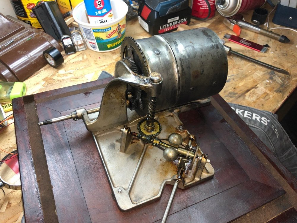

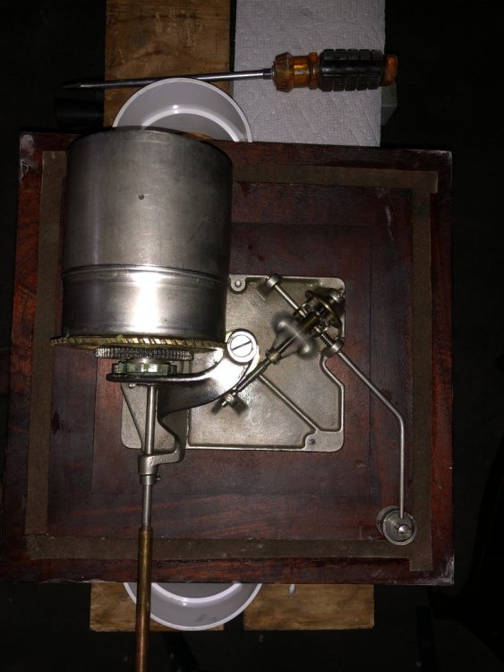

Anyway, I just couldn't help myself and tore into the machine.
I thought I would find a broken spring but it ended up being the winding drive pin.
I repacked the springs (wow, that old graphite was a mess) .... cleaned and lubricated everything (governor was frozen ... working free now) ...

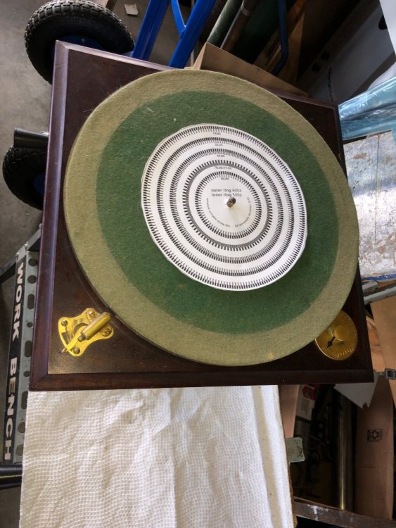

I was actually amazed ... I downloaded a strobe app for my phone (I knew this think could do more than make calls), printed out a strobe test pattern and checked.  It is amazingly stable!.  Printing out the test pattern allowed me to calibrate the speed setting dial.
Still need a few parts to make it complete.

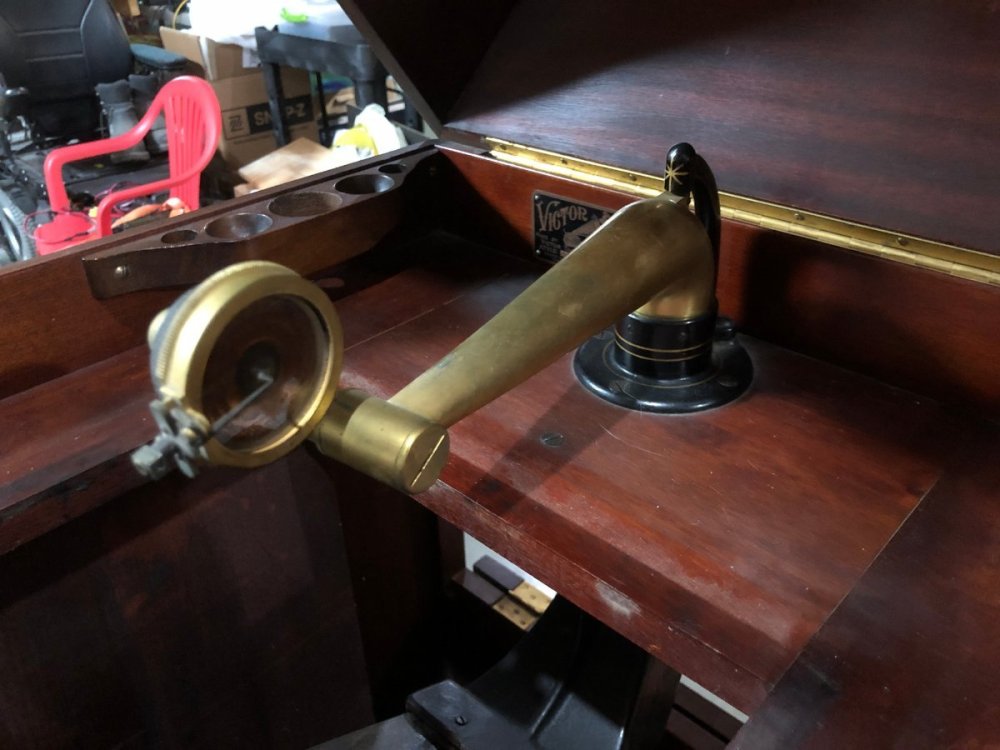

I have parts for the reproducer on order ... should be here in a few days .... that will be my next challenge.
The case has a lot of deep scratches and the finish is cracking (rough and flaking).  I don't want to refinish it ... I would rather it be a survivor and look it's age.  It will never be perfect, even some of the gold finish is missing (just for about an inch) from the arm on the back side of the reproducer (looks like the rubber isolator melted into the finish and someone rubbed through the gold finish trying to clean it).
I am still arguing with myself but thinking maybe Restor-A-Finish (Howards) or ???   ... open for suggestions here!

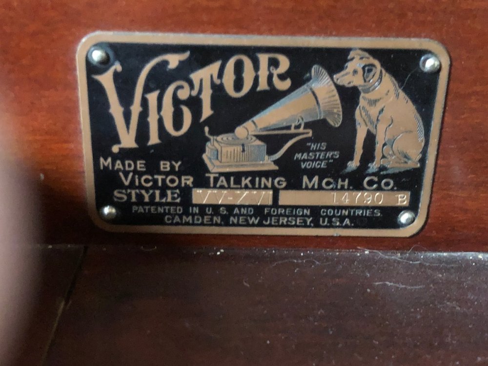

Very nice machine.  That is a very early L-Door.  Most of the L-Door machines after the VTLA had the later decal in the lid.

Lovely machine. You have the 1909 iteration of the VTLA-type, the "first" Victrola (i.e., with internal horn). More info on this page: http://www.victor-victrola.com/XVI.htm
This is the second cabinet design after the Pooley flat-top, which was technically the first.
