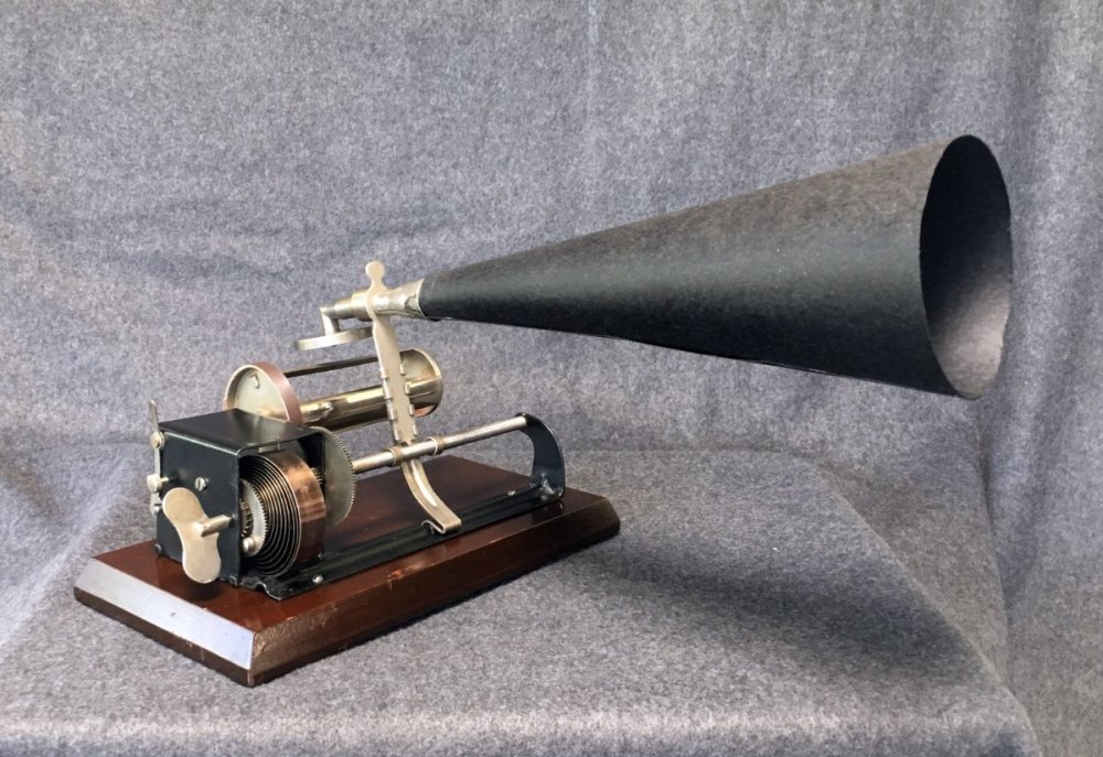

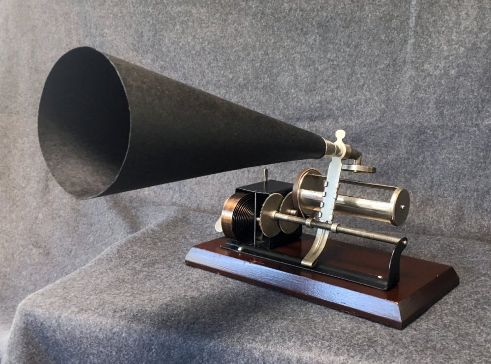

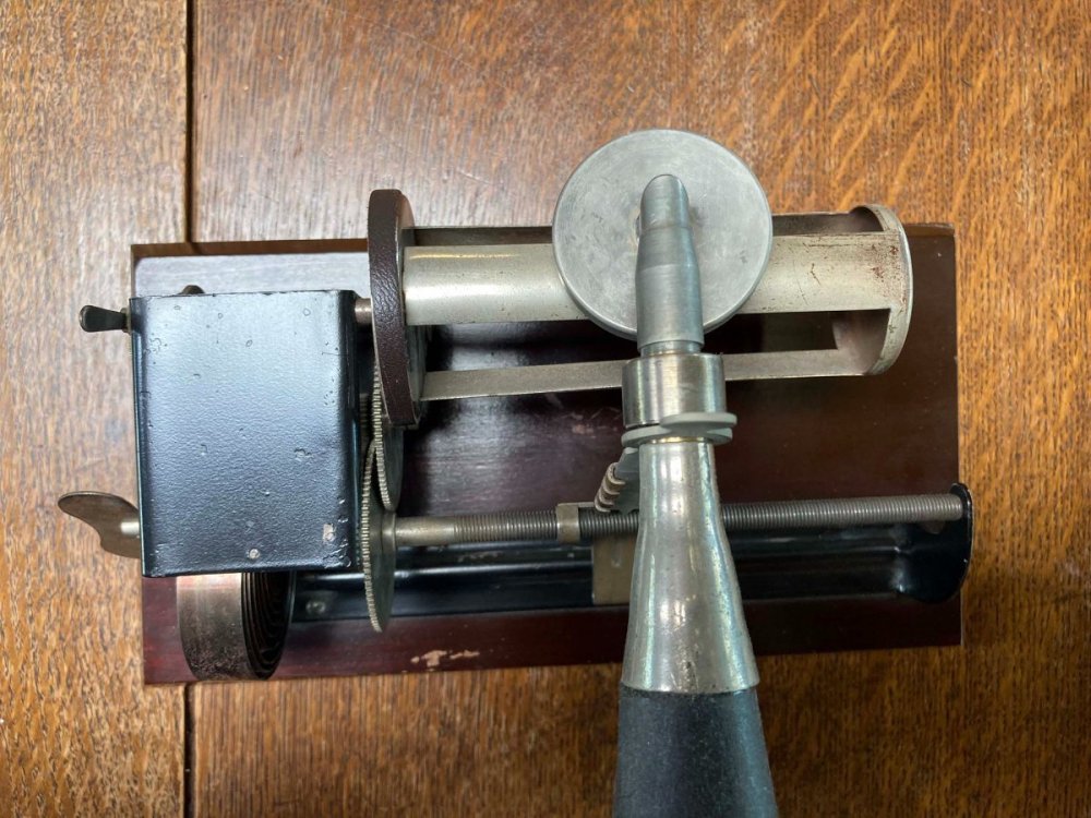

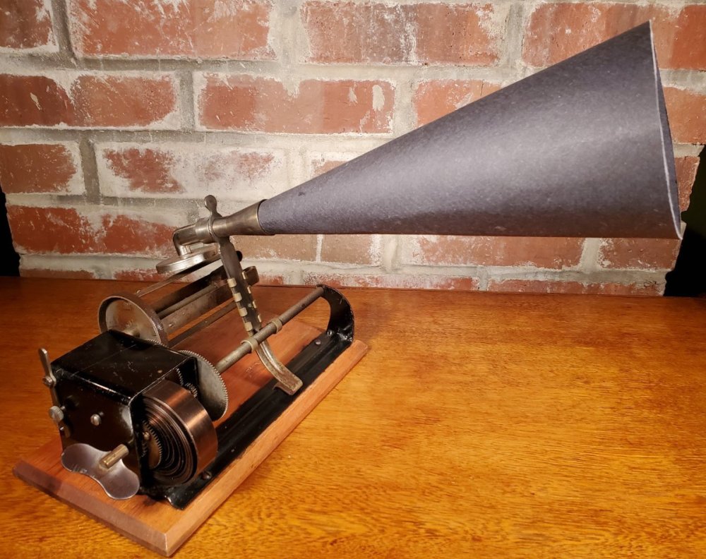

Is this the machine you mean? These were patented in August 1905, and were most likely marketed sometime around then and perhaps into 1906. There are two different styles of mandrel known, but the reason for that is a mystery.
The sound quality is mediocre at best, but then again I have not bothered to try rebuilding the reproducer. This is definitely more of a shelf-queen than an everyday machine.
I'll be happy to take more detailed pictures for you if this is indeed what you're thinking of.
Oceanlinerfanatic191
Yes! That is the machine I was talking about. I believe the mandrel was designed that way because of Editions patent. I do not know much about it so take what I say with a grain of salt.  The simplicity of the machine is very intriguing to me. May I see more pictures of the reproducer or perhaps even here it play? Thank you
I have no doubt that you are right about an attempt to avoid Edison patents. I suspect they went out of business before Edison could even get around to litigating. I doubt Rector's ploy would have worked -- Amet's 'notched' mandrel on the Echophone certainly didn't.

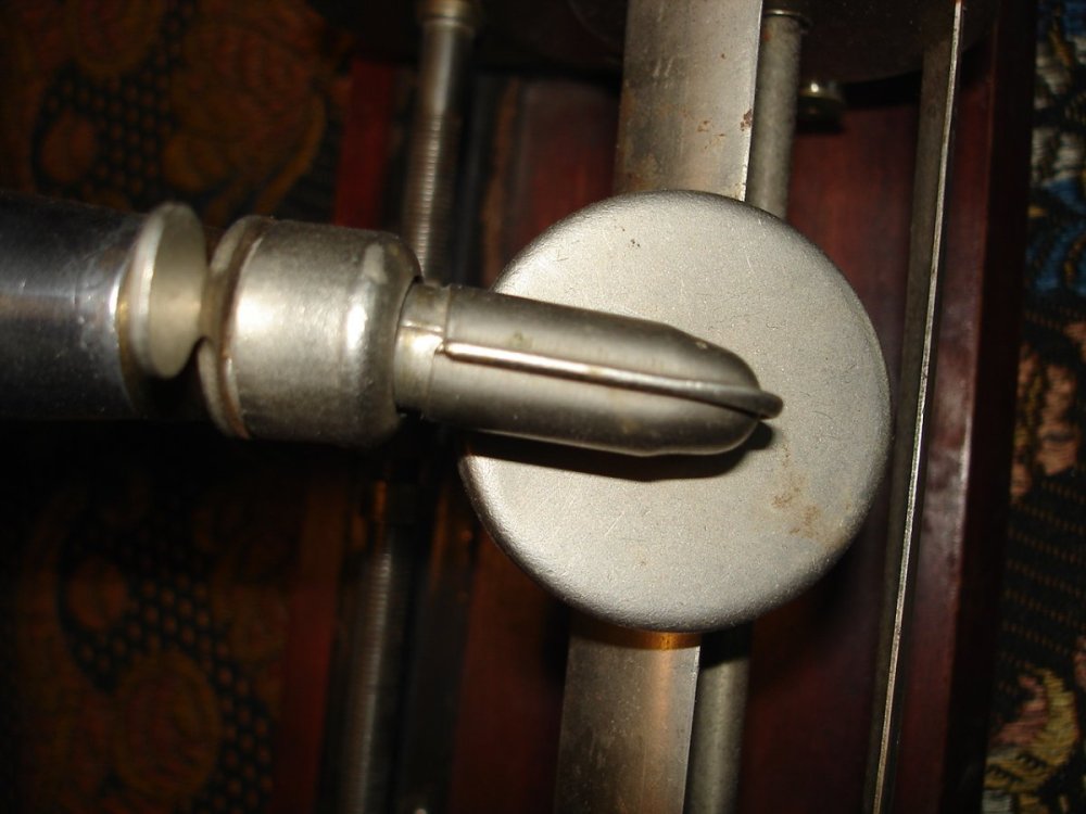

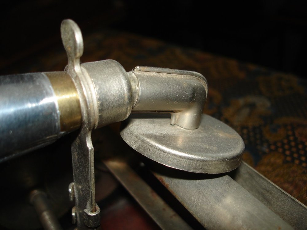

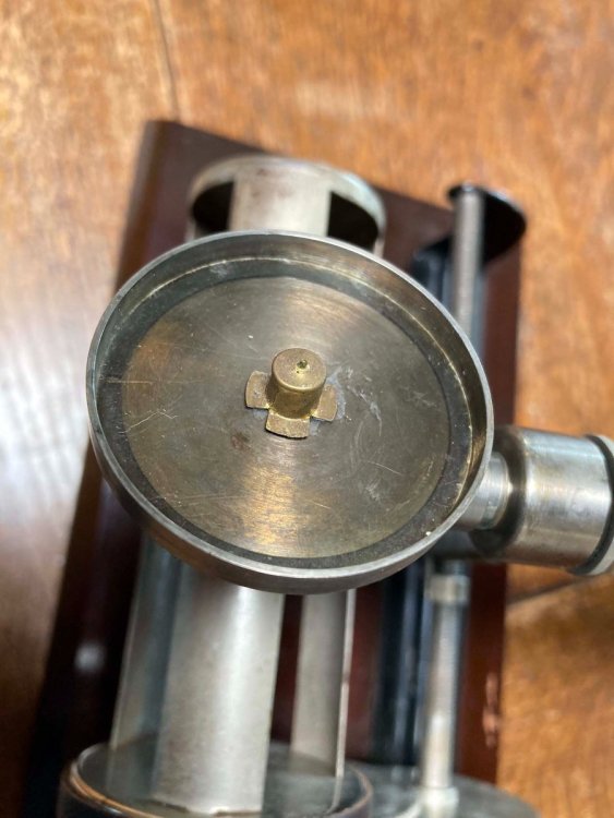

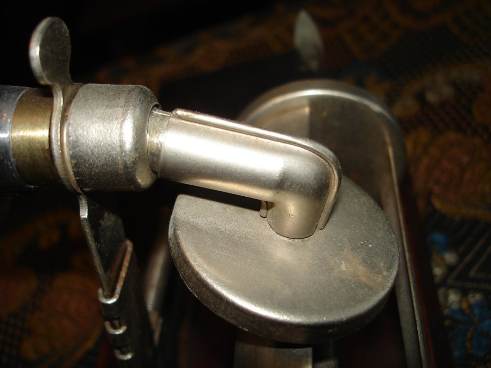

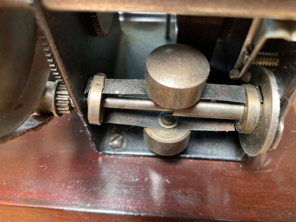

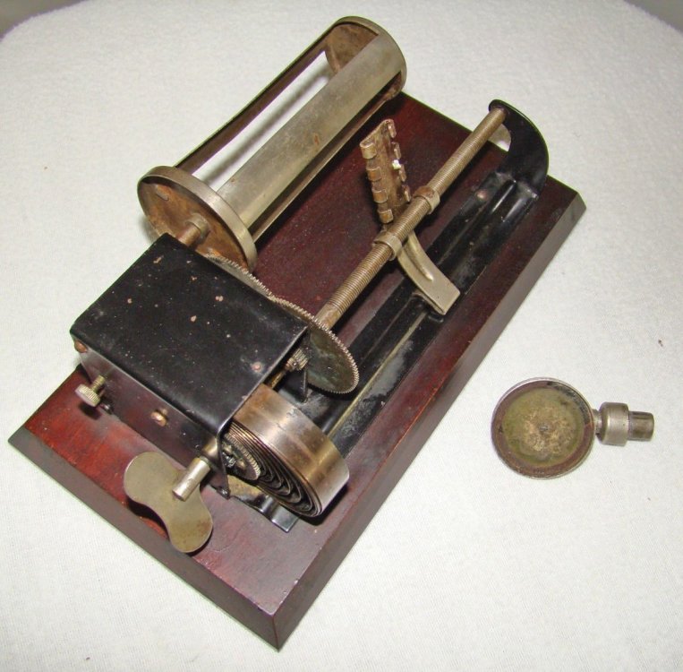

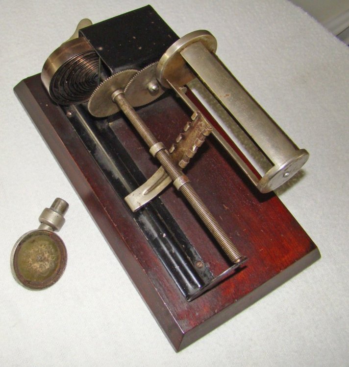

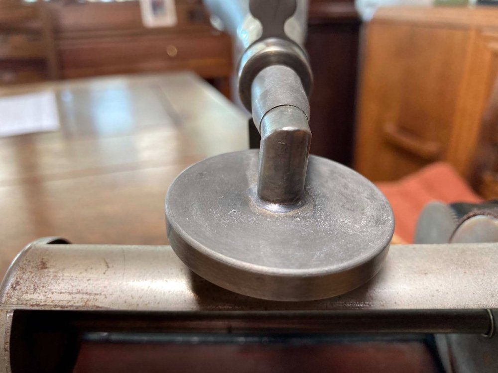

Here are a few pictures of the reproducer and governor.

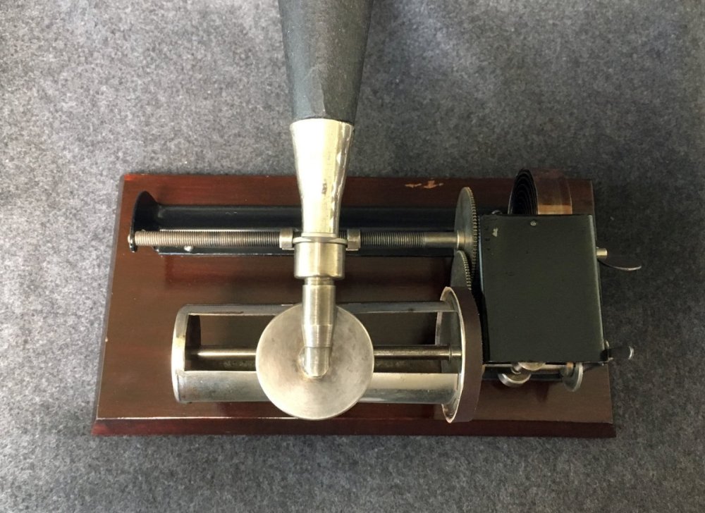

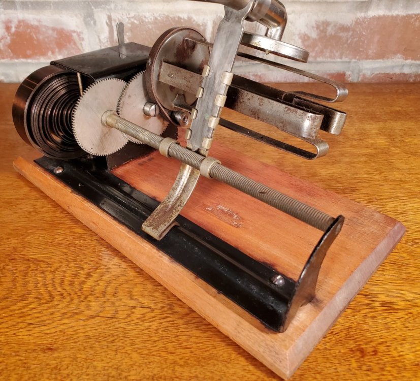

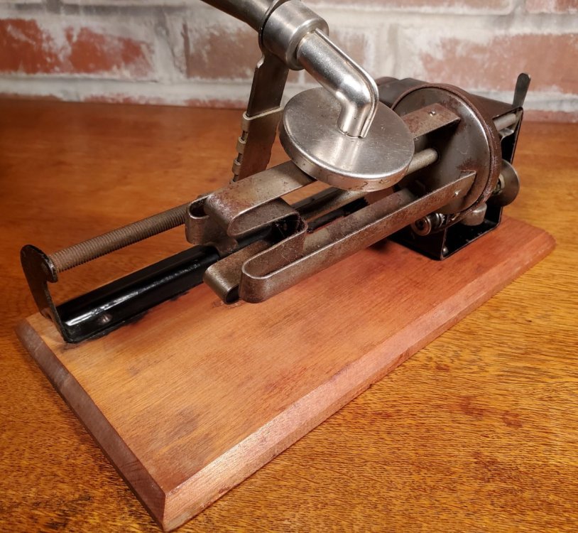

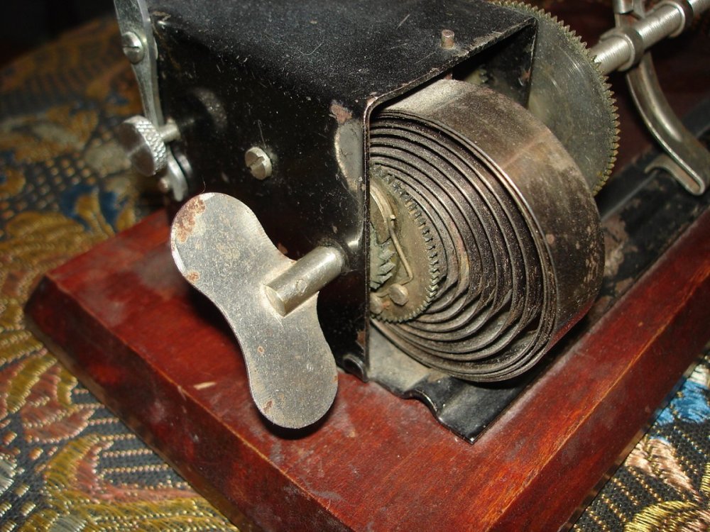

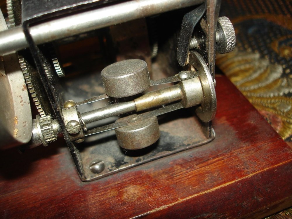

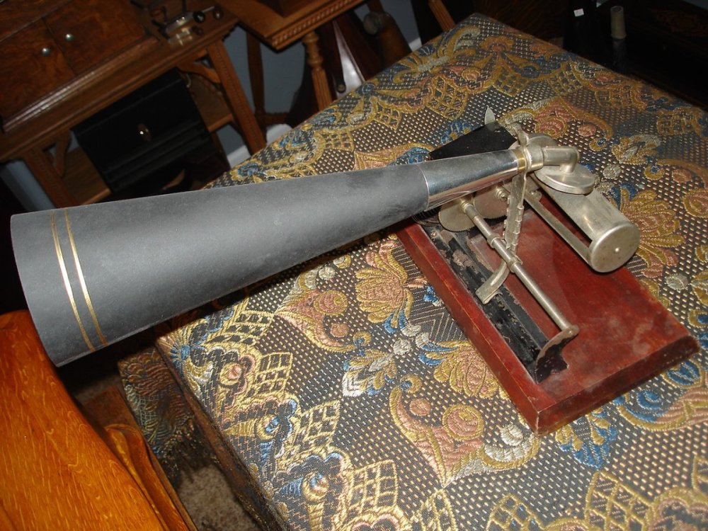

Here are some views of mine...

Thanks for those great pictures. I love the striping on the horn. Any chance that is original? These are obviously super-fragile. I'm also glad to see that it's the third to turn up with a cut-out mandrel rather than the version seen in original ads and a few surviving machines, with loops of metal forming a very strange mandrel.
It's also interesting that yours has a ridge on top of the reproducer tube, and the governor balls are totally flat rather than slightly curved as on mine. That's a lot of little variations in what must have been a tiny production run.
Edited by Tinfoilphono
  • Like 5
Thanks for the comment on the horn. It's not the original, unfortunately.
The ridge on the reproducer tube is actually a crimped joint. The tube is made from two pieces, a right & a left half, joined togther with a crimped seam.

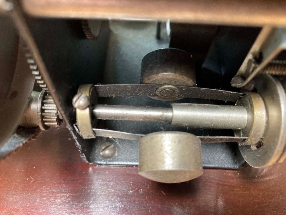

Aside from the very different construction of the reproducer tube, I just noticed that your governor springs are screwed to the governor. On mine they pass through a slot at each end and are riveted. Again, it's bizarre that there are so many variations in a machine this obscure.

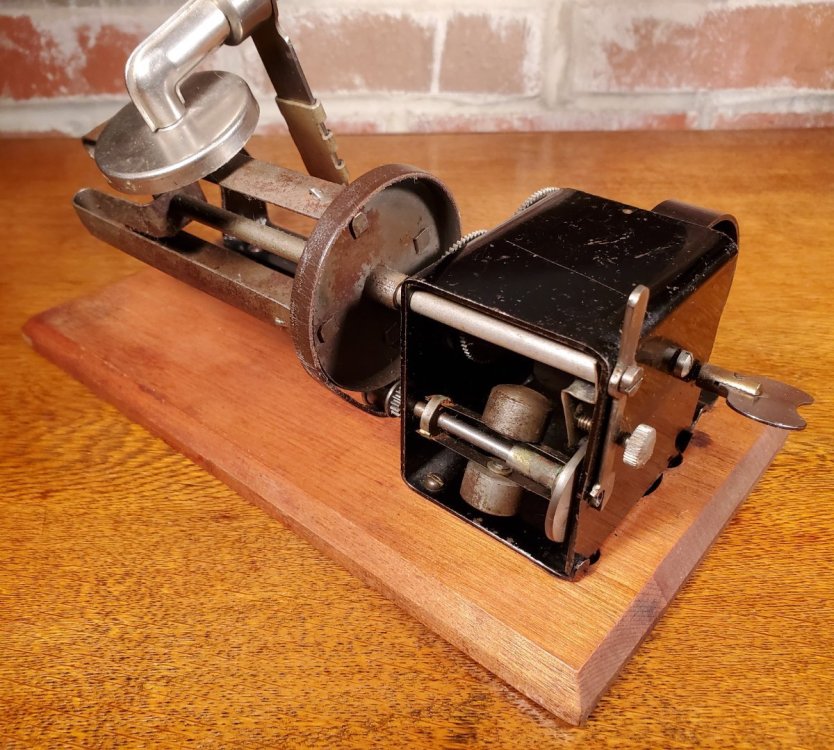

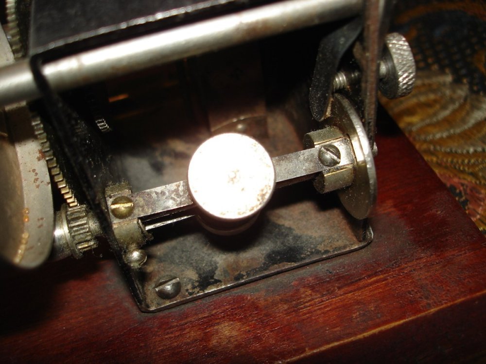

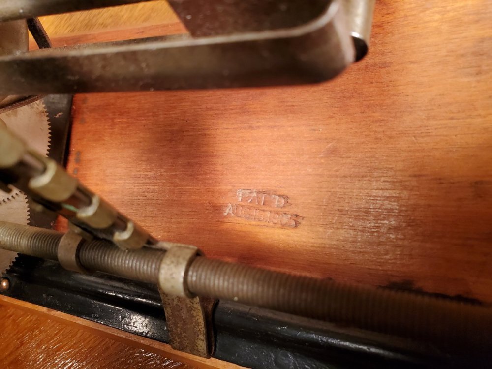

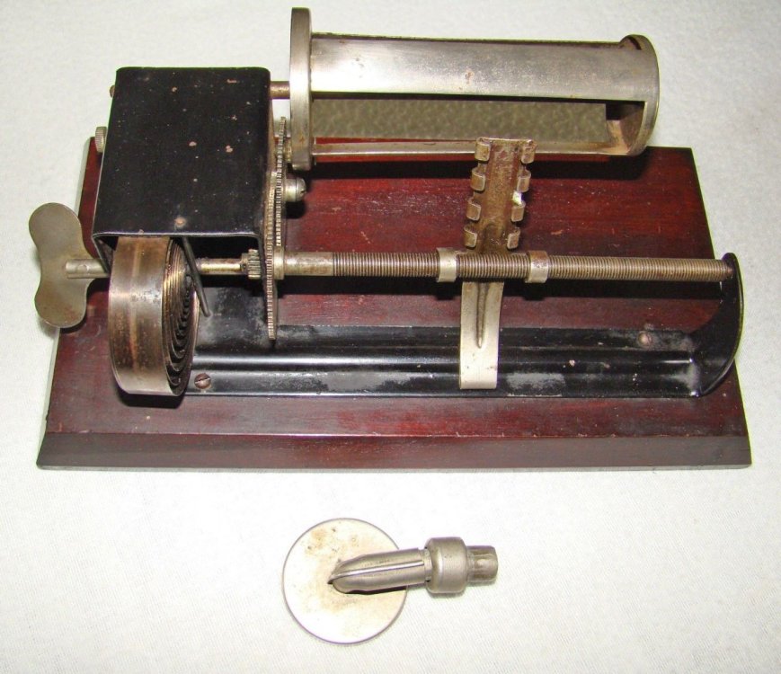

Well, the only Rectorphones shown so far in this thread are the more uncommon (in my experience) versions, with a more refined mandrel and substantial dark wooden base.  Here's the first (I believe) version with a flimsier light wood base (I've seen several of these noticeably warped) and the "eggbeater" mandrel...

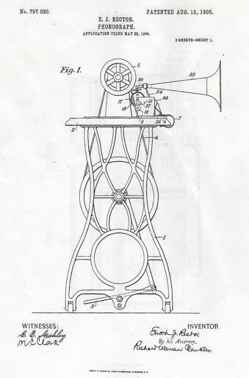

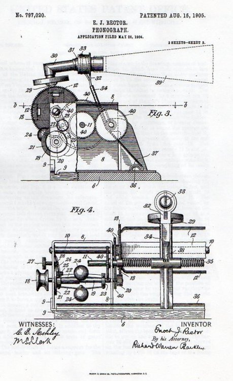

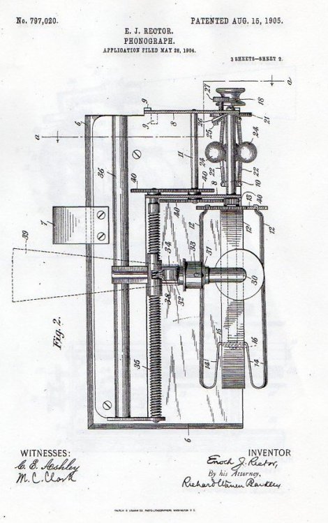

For those who haven't seen the U.S. patent, it's interesting to see that Rector's original intent was to have his talking machine powered by an existing sewing machine treadle commonly found in homes of the time.  Evidently, common sense prevailed, and a simple mainspring and gear were added.
The patent also shows a gear driven mandrel!
George,
I believe yours is the first I've seen with a patent date. To further muddy the waters, your example has some similarities to my machine and some similarities to Rene's, and of course some details all its own.. This has become a really fun thread!
This is indeed interesting. There's more to this story than I ever imagined. I only knew about the two different mandrel designs.

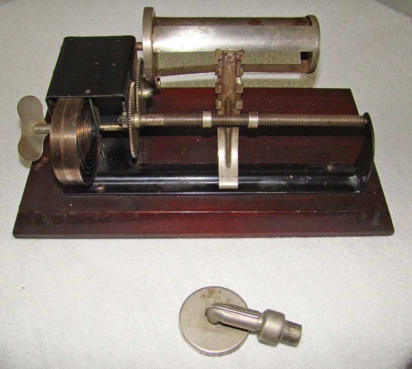

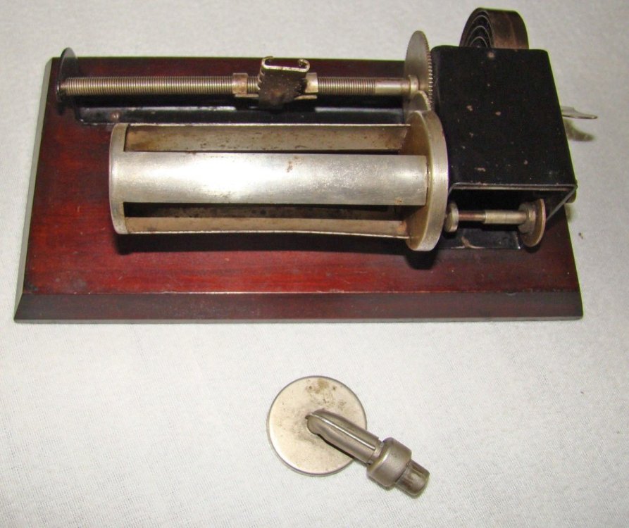

Here's another example, which appeared on eBay in 2018, selling for $530. It was incomplete, missing the reproducer support rod and the horn ferrule. Yet another with the (presumed) later mandrel style.
