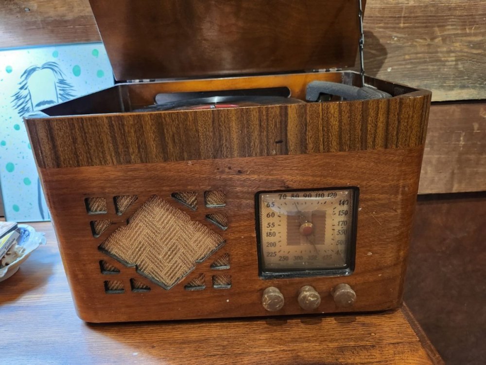

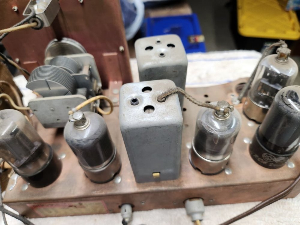

569Boat Posted February 25, 2024 Posted February 25, 2024 I have a Sonora radio/record player and would like information on its year of manufacture and/or duration of production. The only number I can find on it is 899906, which isn't identified as a model or serial number. I cannot find anything online that looks like it. I am ordering tubes for it, but the capacitors seem to be difficult. 1

BenL Posted March 26, 2024 Posted March 26, 2024 (edited) It is a little late, the focus here is primarily pre-1930 acoustic machines. (But it's a 1942-1943 model A29124.) Edited March 26, 2024 by BenL

electrolaman Posted March 31, 2024 Posted March 31, 2024 Hello 569Boat!, Well this is in fact a 1941-1942 Sonora Model LTF-164. I hope you have a schematic pasted inside the cabinet as I cannot find one in the usual books. You may have a problem with the pickup being crystal and it may be dead. Replacement pickups are possible but they do not look the same as the original. Crystal pickups can be rebuilt but unless you send it to a man in Germany who makes his own crystals the US rebuilders use piezo elements which work but do not sound as good. Best of luck with your restoration! Carlton Smith 1
569Boat Posted May 2, 2024 Author Posted May 2, 2024 ElectrolaMan, if I haven't thanked you before; thank you! This has been extremely helpful. I can find the schematic for MTF-164 and, using the photos I've taken and the tube numbers off of that schematic that I've ordered, it's pretty darn close. Again, many thanks
