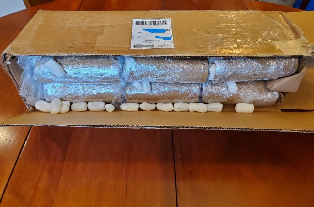

Here are 11 Columbia Type C cylinder records in their boxes, which arrived just yesterday.  My heart kind of sank when I saw the size of the unopened box...  But once again, good luck smiled upon these records, and perhaps they will survive for another 125 years.  The 13 packing peanuts fell from the upper inside edge of the box as I opened it.  I am grateful to the seller for wrapping the boxes in saran wrap (which I requested) as well as the records themselves (which I did not).  I suspect that the extra wrapping aided in their survival...but I'm awfully glad no substantial weight was applied to this box!

As you can see, the seller of the Type C cylinders did well with #1 and #2, but lost interest with #3 and #4.  This message was within 2 or 3 characters of the eBay message limit, so you can't be too chatty.

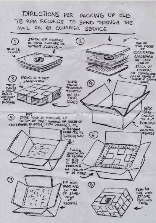

For disc records, I will - whenever possible - send this illustration posted several years ago by a kind and thoughtful collector on another forum.  If I knew his name I would acknowledge him.

-  Multiple groups in inner boxes surrounded by packing peanuts, much like georges diagram above
