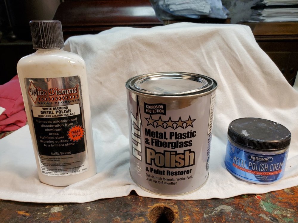

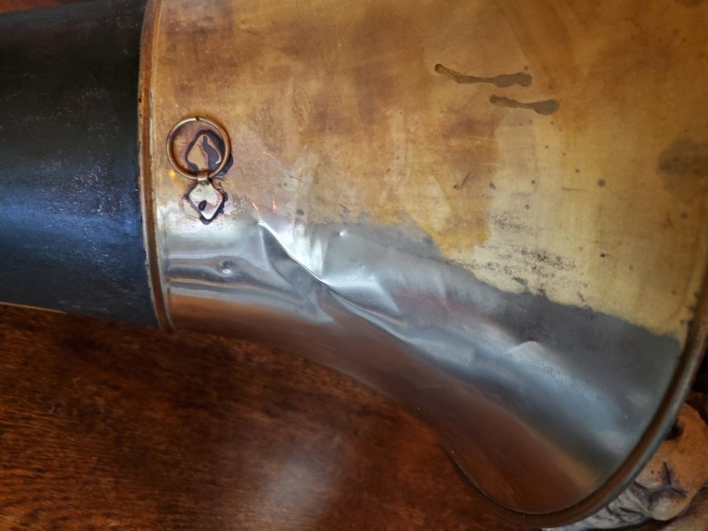

phonogfp Posted November 11, 2023 Posted November 11, 2023 Today on one of the Facebook groups, someone posted "before and after" pictures of a 14" Edison black and brass horn. Here's the "before..." Admittedly, that was heavily oxidized brass. We've probably all seen worse, but this horn looked like it would require a couple of hours of elbow grease. Well, I'll bet it didn't take nearly that long to achieve this result: The supposed miracle cure was Barkeeper's Friend, a moderately abrasive cleanser that certainly has its uses, but not for this application. Compare what abrasives do (above) to what polish does (below): A picture speaks a thousand words. I'll only add that soft metals like brass and aluminum are easily scratched by even moderate abrasives like Barkeeper's Friend and Brasso. They won't leave a reflective surface, but rather a dull glow - the result of thousands of tiny scratches. Here's an aluminum horn shown partially polished by hand - using POLISH: The moral of the story (in case it hasn't already been beaten to death) is that POLISH is preferable to products such as Brasso and Barkeeper's Friend. Sure, it takes longer and your fingers may be sore the next day, but...isn't it worth it? I recommend easily obtainable polishes (auto parts stores or Wal-Mart) such as Mothers, White Diamond or Blue Magic. For heavily oxidized surfaces like those shown above, start with Nevr-Dull cotton wadding. I've had wonderful results with these products. (See 3/22/24 post below for an even BETTER suggestion when dealing with heavy oxidation/tarnish...) George P.

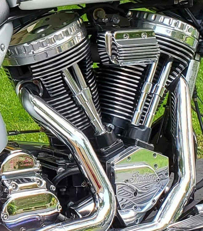

phonogfp Posted December 1, 2023 Author Posted December 1, 2023 A buffer and grades of rouge is definitely the way to go for a professional-grade polish, but many folks don't have one, and the process makes a mess. I admit that I've had many horns professionally polished by experts (like John Duffy). But for some horns, often based on the machine to which they're attached, I prefer a less-than-pristine-yet-polished look which can be achieved by hand. Additionally, polishing the upper works of a Type BG Graphophone or other casting with complex contours must be done by hand. The proper products will spell the difference between mediocrity and success. George P. The engine below is not chromed - the rocker boxes (the large bottle-cap looking things on top) and the cam chest covers (at the bottom between the pipes) are raw aluminum. They were dull, but repeated polishing by hand (2 or 3 times) with the proper polish made them shine like chrome. 1

phonogfp Posted December 13, 2023 Author Posted December 13, 2023 On 12/1/2023 at 11:15 AM, CurtA said: George, the hand polishing looks great - I just don't have enough patience to do a large project. It's good that we're all wired differently. I truly enjoy polishing up dull metal. A lot of the guys on motorcycle forums substitute chrome components for the original aluminum pieces on their bikes - and that's a smart move if you don't like polishing. (The bike companies make a great income on these chromed accessories too!) My motorcycle came with all its aluminum pieces still intact, and after 20 years I'm not inclined to change them out - especially since I enjoy the polishing. I've had a couple of guys look closely at the bike and say something like, "Man - you must love keeping it clean!" My response around mixed company will be something like "I sure do!" If it's a biker, I'll use a more powerful affirmation that rhymes with "Stuck in Hay." I have an AG Graphophone with an aluminum bed plate that needs polishing. It's a busy time of year, but when I get to it, I'll post "before" and "after" pictures here. George P. 2

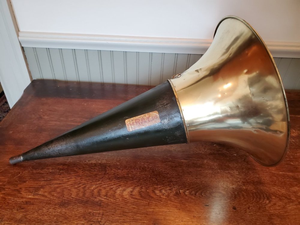

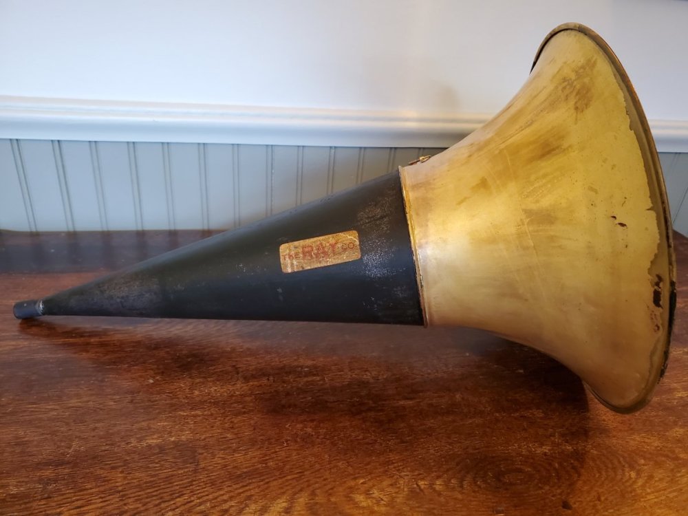

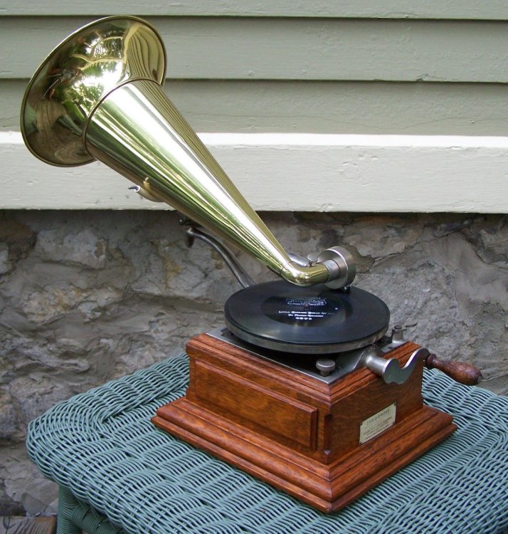

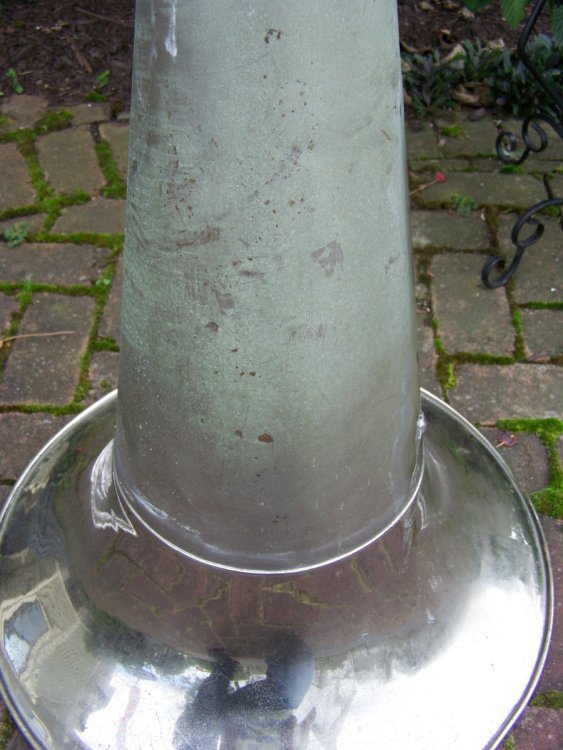

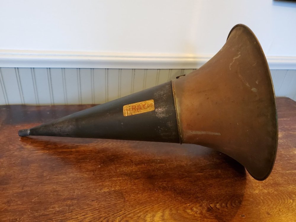

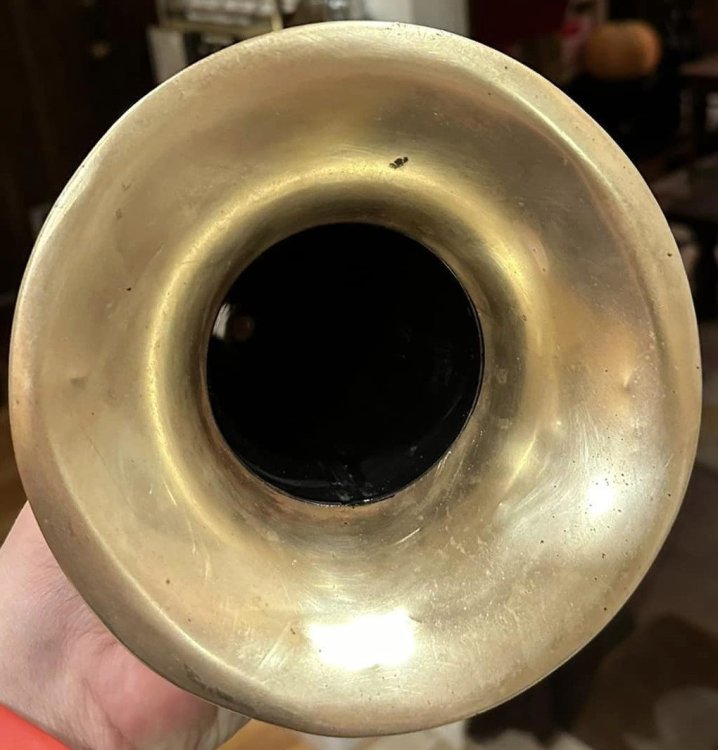

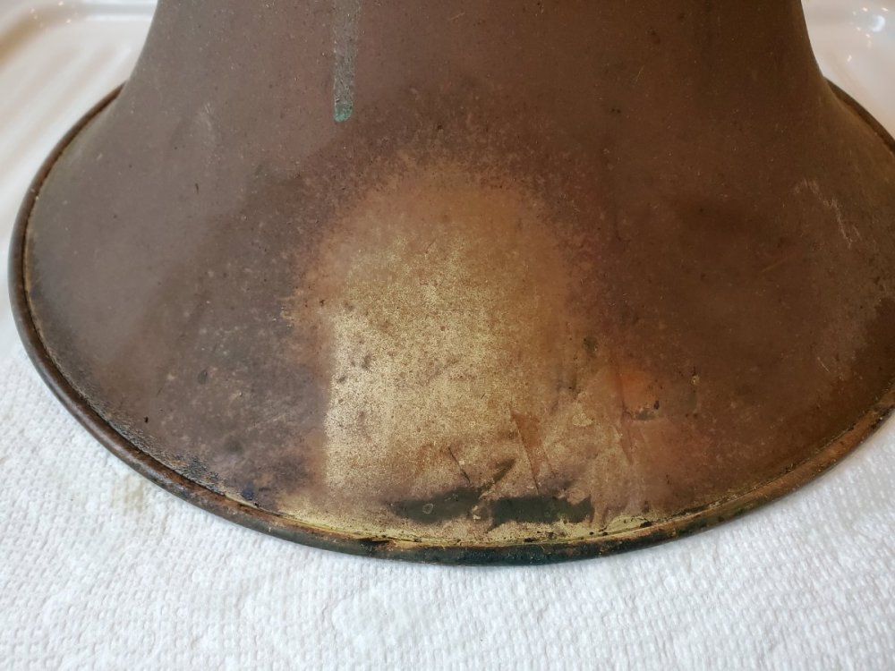

phonogfp Posted March 22, 2024 Author Posted March 22, 2024 As promised, here is a metal polishing project I just completed. It's not the AG Graphophone yet...that will come later. This one is the brass bell of a horn: Here's what the horn looked like until yesterday: I bought this 22-inch horn at the 2022 Midwest Music EXPO (MME) at Chicago. I was attracted to the bell geometry, as well as the "Ray Co." decal. However, I blame the heavily tarnished brass bell for the many, many months this horn sat in my shop. I've cleaned heavily tarnished bells like that before, and it's a long, painful process - and I'm often dissatisfied with the results. I decided to give it to John Duffy and have him work his magic. The only thing that bothered me about that plan was that the brass would look great, but the paint and decal definitely show their 120-odd years. I did, however, gently clean the paint, and to my surprise, I discovered that the paint is not black, but very dark green! I really like this horn. In spite of the possible incongruities of aged paint/pristine brass, I would probably have taken this horn to John anyway (just to avoid all that tarnish), but circumstances last year prevented my attending either of the Wayne shows. Meantime, I heard about a product called Flitz Tarnish Remover: Naturally, I could not find it locally, so I ordered it on Amazon. It arrived a few days ago, and I looked forward to trying it. The directions are explicit in their warnings to NOT let the product dry. Okay, I'd be careful, and try a small spot to see how it works. Here's the result of a small spritz, a 1-minute wait, and a rinse with water: Hmmm... Not bad - not bad at all. This stuff IS NOT A POLISH. It simply removes the worst of the tarnish. I went to work, doing the outside of the bell in 5 sections. About a half-hour later, here's the what it looked like with the tarnish removed: Now it was time to polish the brass. I wanted to use this opportunity to try out some polishes I use on phonographs and my motorcycle to see which would work best for this application. Here are three: I'd love to report that one polish really stood out, but I couldn't tell the difference between these three (I forgot to test two of my other favorites, "Nevr-Dull" and "Mothers"). As a matter of fact, the Flitz and the Blue Magic look the same, smell the same (like ammonia), and worked the same. Like its Tarnish Remover, the Flitz Polish directions warned to not let it dry. For that reason alone, I used Blue Magic so I could work on larger areas without worrying about drying. Here's the difference between the area treated with Tarnish Remover and Polish: Here's the final result: I might take the horn to John to have him remove the creases, but on the other hand, this is a horn with character, showing its age, and those creases don't bother me too much. The main message of this posting is the Flitz Tarnish Remover. It worked like a miracle, removing the tarnish from the inside and outside of this bell in about a half-hour. The polishing actually took longer, but polishing is fun and not nearly as tiring as removing serious tarnish by hand. I LOVE THIS PRODUCT. George P. 2
Henry Posted March 22, 2024 Posted March 22, 2024 Just to echo the comment, far above, about Brasso: when I was doing the music thing for money back in the day, the word was never use Brasso to shine up your horn (trombone, in my case); it'll strip the lacquer right off. That's in addition to its being abrasive/scratchy. I never got the opportunity to prove or disprove the accuracy of that advice, because I didn't dare risk messing up my horn. 1

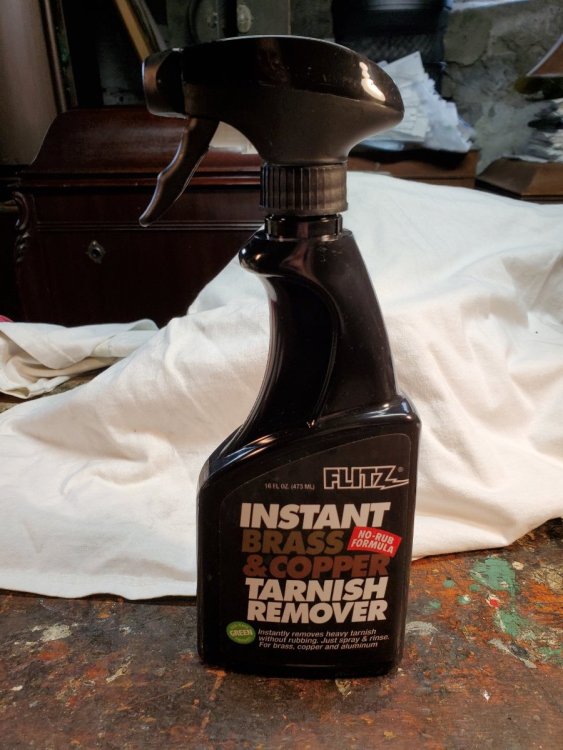

melvind Posted March 22, 2024 Posted March 22, 2024 I've been using Flitz for years. It's the best thing I have found for horns. 1
Tinfoilphono Posted March 22, 2024 Posted March 22, 2024 Wow, that's an amazing result on an even more amazing horn. I love it. I've used the Flitz tarnish remover in the past. It is indeed a great product. 1

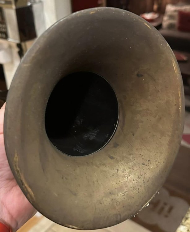

BruceW Posted June 12, 2024 Posted June 12, 2024 Has anyone tried the Flitz Tarnish Remover on Nickel plated horns? I have a nice horn that I am currently working on and so far the inside has come up very nicely with just 0000 steel wool and GOOP/GOJO but the outside is heavy tarnished and these are not completely removing the years of build up.
phonogfp Posted June 12, 2024 Author Posted June 12, 2024 The label says it's okay for painted surfaces, which suggest to me that nickel plate would be okay as well. Just no chrome or various stone surfaces. I'd put a little on a Q-tip and try it in a hidden spot. George P.

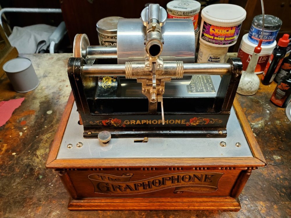

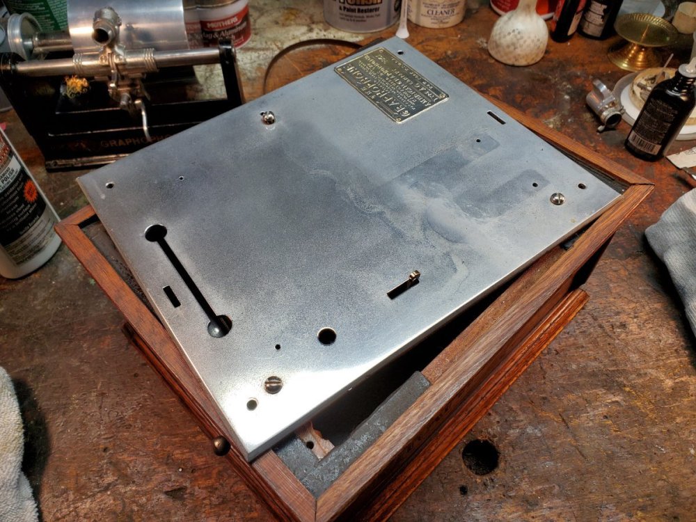

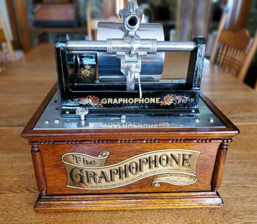

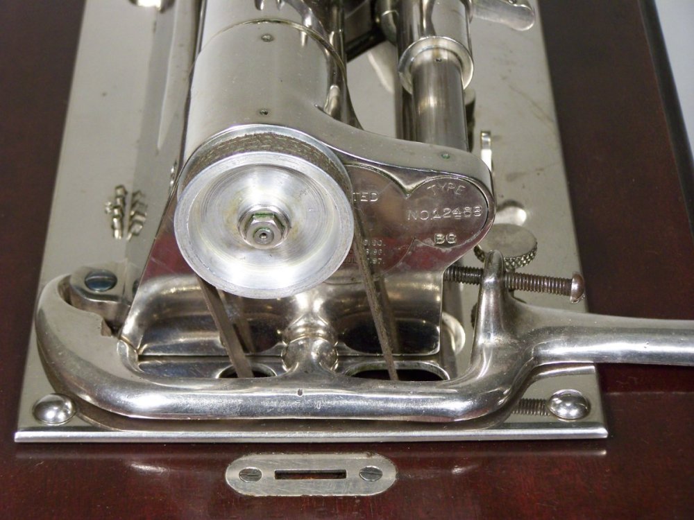

phonogfp Posted May 30, 2025 Author Posted May 30, 2025 About 18 months ago in this thread, I mentioned that there was an AG Graphophone here whose bed plate needed polishing. Being the man of action I am, yesterday I finally tackled the job. I nearly forgot to take any "before" pictures. By the time I remembered, the AG was sitting on the workbench, and I didn't feel like carrying it back upstairs to a better place for a picture. The problem with my workbench is that, in addition to a couple of incandescent swing arm lights, there are a couple of florescent tubes above. These florescent tubes throw a harsh white light that makes aluminum look foggy. Did I disconnect the florescent tubes for pictures? No. But, despite my screwup, I think these pictures demonstrate the value of polish and hopefully discourage the use of steel wool. Here's a "before" picture on the bench. Note how the cast aluminum bed plate looks kind of milky after at least a decade of no polishing. Note the faint reflection of the speed control on the bed plate. Here's the bed plate with the left half polished. The florescent tubes make this look milkier than it really is. Still, cast aluminum - unless it was carefully polished mirror smooth at the factory - contains tiny pits that will never look like pristine nickel-plated brass. Okay, here's the reassembled AG still on the bench after polishing all the metal with White Diamond polish, and treating the cabinet with OZ. You'll see a slightly better reflection of the speed control, but those darn florescent tubes still make things look milky: Here's what everything looks like without those pesky florescent tubes: Wow - this little treatise turned into a lecture on lighting! Check out the reflection of the speed control now... You're not using steel wool to polish metal or displaying your phonographs under florescent lights, are you? But seriously folks, florescent light will definitely fade old dyes, such as those used in period advertisements and the floral decals found on Graphophones. George P.
Jerry Posted June 4, 2025 Posted June 4, 2025 (edited) Beautiful work! I love the Flitz tarnish remover as well. Surprising, how few people know of it. I bought it in a gallon jug. That way, I pour it in a bucket and can fully immerse small items. When done, I pour the remaining remover back into the jug. So far, no degradation of the solution due to reuse. For polish, I really like Semichrome. Even with extremely thin and delicate nickel plate, it does not seem to remove any additional plating. Curt's buffer is a great tool. Do not use it on plated parts however, unless your goal is to remove plating. 😉 Edited June 4, 2025 by Jerry
AtRicky1 Posted January 7 Posted January 7 Your AG Graphophone. Absolutely stunning. Can't say any more...well maybe...beautiful!

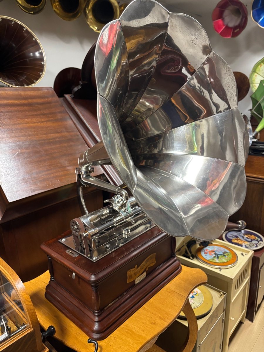

BruceW Posted January 10 Posted January 10 Polishing Nickel Plating is as described above tricky but very rewarding. I use a buffing wheel for most parts that have thicker plating. For heavy projects I start with a "spiral sewn" cotton wheel with white polishing compound and for the final polish or lighter jobs I use the "loose cotton" wheel with jeweler' rouge compound. With the horns (especially Columbia) the plating is too thin to use a polishing wheel so back to elbow grease. As George described the Flitz Tarnish Remover is excellent to remove the heavy encrusted finish and then Flitz metal polish by hand is excellent in bringing up the final shine. I also like to use Renaissance Wax to protect the finish that I have worked so hard on. Here is a recent prize that I found that came up clean and polished like brand new. The horn, however, is a replacement that a fellow collector had on a shelf since the 80's, as the original mahogany horn was eaten by the sellers dog.

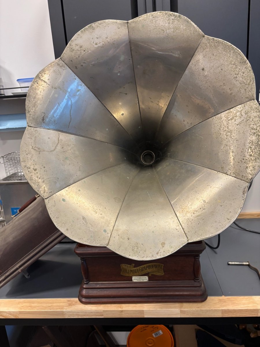

BruceW Posted January 24 Posted January 24 I would love to polish this lovely horn for you but it would cost a fortune to send such a large horn to me and then back to you. Oh well, there are benefits to living in Canada but shipping phonograph items here is not one of them.
