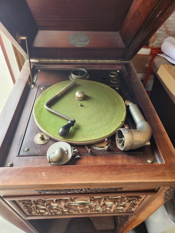

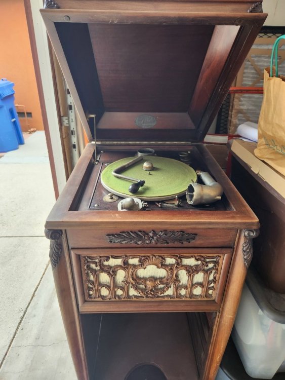

I was recently gifted a Sarola phonograph, but can't fi d much on it, and I'd li,like, to get it up and running.  Any suggestions?
Thank you
Sarola was a regional brand made for the St. Louis trade, sold through local department/furniture stores to give the impression they were offering a local brand. In reality it’s a supplier phonograph. This model was made in mass unbranded. Allowing any business to slap on their own tag/decal to give the appearance they were offering their own house brand. This same model appears under almost a dozen different brands. Meteor, Liberty Bell, Mastertone, Jewel, Perfectone, etc. It dates around the late teens/early twenties.

The benefit of it being a supplier phonograph is that the parts were in made in mass. You can find a hundred other brands that used the same parts like the motor, tonearm, etc. (You just have to know what you're looking for.)

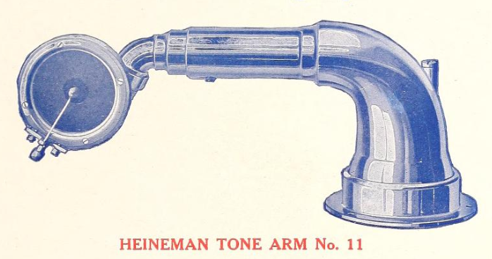

It looks like it's using Heineman No. 11 tonearm and a No. 2 sound box/reproducer. Heineman was a company that made parts in mass for any business assembling their own phonograph.  Many smaller independent brands went to local/regional furniture makers for the cabinets, with the mechanical parts contracted through Heineman. Slap on your own tag/decal, and voila, you have your own house brand.
Heineman parts are fairly easy to work on, with the exception they use pot-metal, which becomes brittle overtime.
