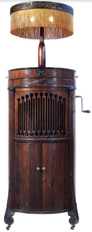

I'm beginning the restoration on a Modernola machine that is missing the top latching hinges and "lamp shaft".  Is there anyone in Southern California that has one that I could look at and make patterns from?

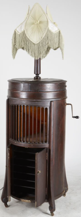

The lamp post is a fairly simple design, which shouldn't be to difficult to replicate - kind of a wine bottle design.

Comparing the pictures to the open lid height should give you the approx. dimensions.
