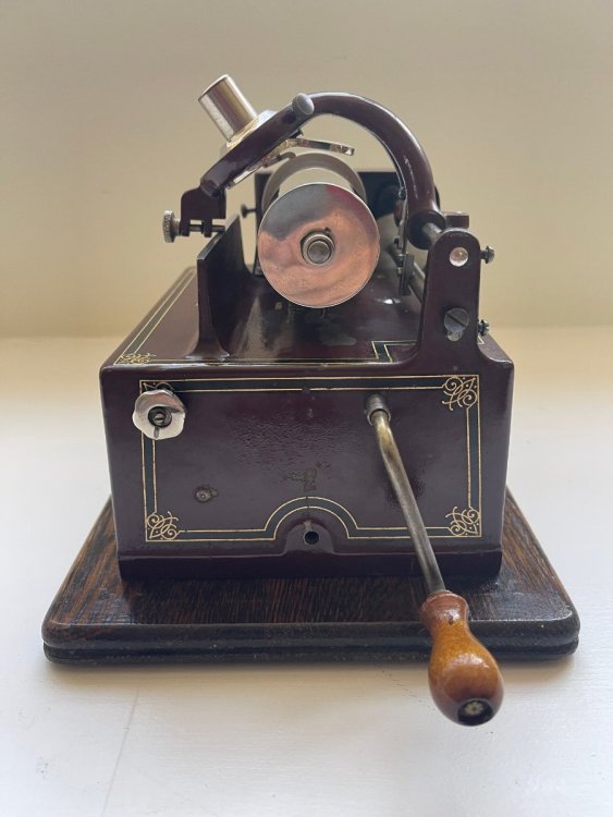

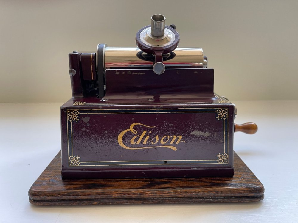

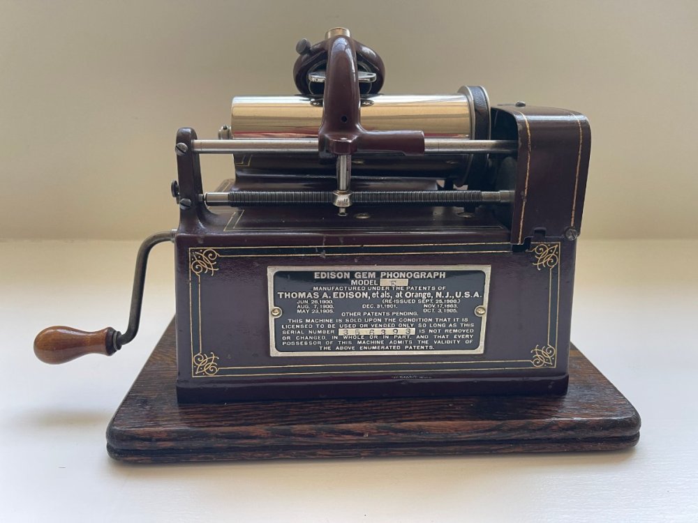

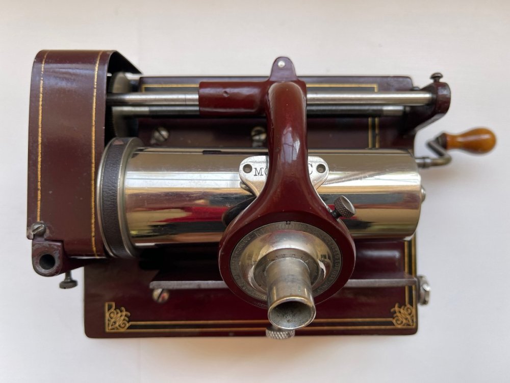

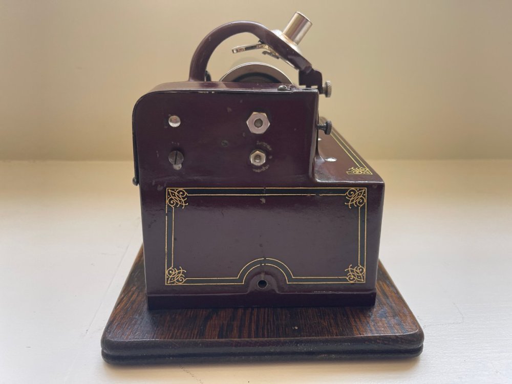

As an appendix to George Paul's article on the Edison Gem Phonograph, the Model E also had an ICS (International Correspondence Schools) variant. This variant was provided with 2 minute gearing only and a Model C reproducer. The mandrel had a larger belt pully on it as did the ICS Gem Model C. The ICS Gem Model E was governed to play 90 RPM cylinders only and could not be increased to play standard entertainment type cylinders. Included are photographs of the ICS Model E....

No markings on case. The mandrel is the easiest identifier.
