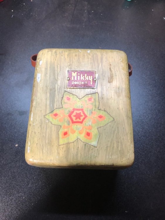

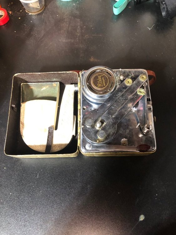

Good morning all I recently rescued this Mikkyphone phonograph , one of the previous owner did a horrendous restoration ???,

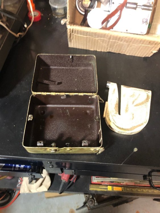

the inside is in great condition , but the case was stripped and painted , I got the ugly paint off and was wondering if there is a product that replicates the old wrinkle paint. See pictures. Any help would be greatly appreciated. Thanks
Dan
Wrinkle painting is different from normal - it requires three coats of VHT Wrinkle Plus (1) horizontal, (2) vertical, (3) diagonal and finish with a heat gun...
Here are the instructions:
4 hours ago, CurtA said:
Thanks Curt very informative I’m going to look into this
