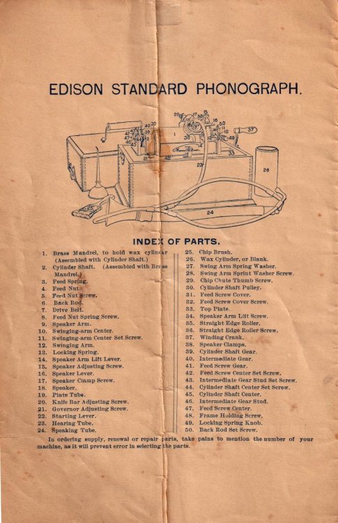

Here are pics of the pdf if you'd rather view the instructions here.
