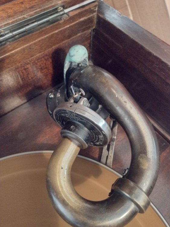

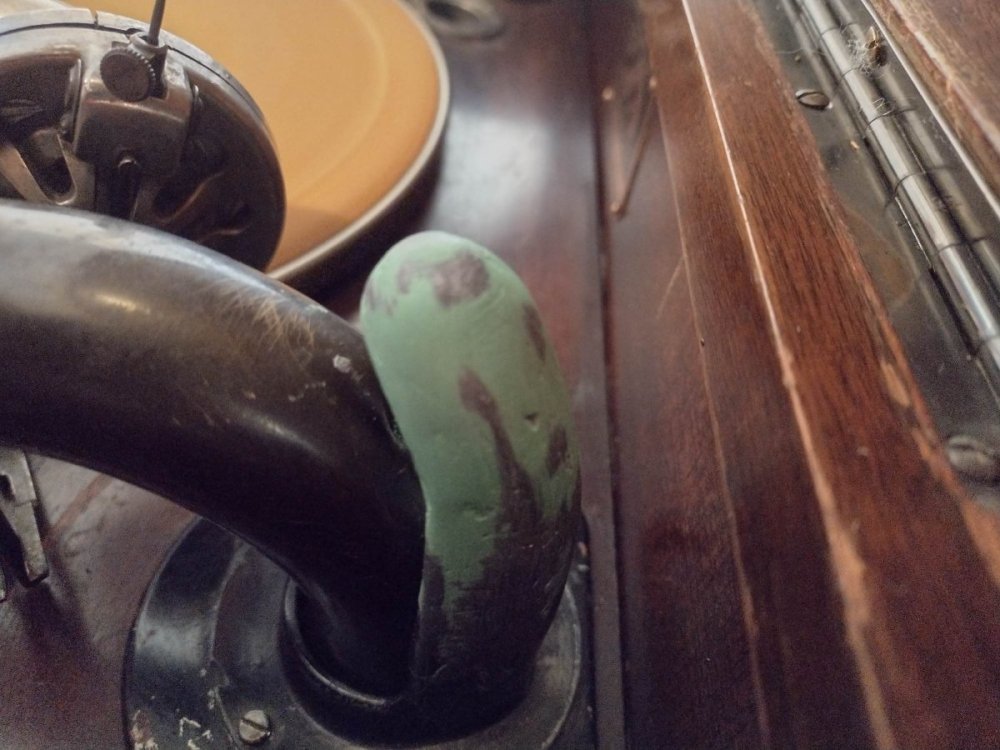

I'm looking at getting this Victrola Paloma, and the tone arm support has been shaped into this strange combination of grey metal and turquoise material.
Any ideas what the turquoise material is?
Could it be oxidation? Can I clean it off?
Thanks for any help!
Percy_Dovetonsils
Looks like a British 2 part epoxy called "Milliput".
Edited by Percy_Dovetonsils
Springmotor70
I agree.  The potmetal often explodes and this one seems to be rebuilt with epoxy.  You could finish the job and paint it or find a replacement.
Cabinfever
Thanks for the replies. The turquoise colour really confused me.  Is there something special about this particular colour/type of epoxy? (i.e. why not use black or grey?)
MisterJive47
The restorer just the same could have used JB weld or a similar metal epoxy putty. Probably just used whatever was readily available at that time. Milliput is popular with scale model makers. I've used JB Weld putty and regular JB Weld 2 part epoxy to rebuild pot metal mandrel end castings before.
