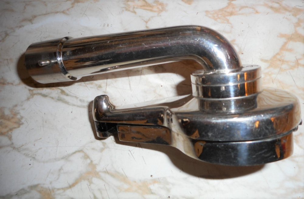

My dance reproducer to my ears sounds better then my two Edisonic reproducer.
I'm also a fan of the Dance Reproducer.
My favourites in order of preference are;
1. Dance Reproducer.
2. New Standard/Edisonic.
3. regular (1915 - 1927) reproducer.
Ediphile we seem to think alike on this subject.
I did not know the dance reproducer improved the sound that well ..  Tom
I wouldn't say it sounds better.  I've got of course the Standard and also the Dance and Edisonic.  I'm almost always using the Standard.  The Dance is a pain to use.  There's not much tolerance for the limit pin to move within the limit loop.  A slightly thicker or thinner disc will skip or worse yet cause the limit pin to make contact with the reproducer body, putting a nice gash in your record.  Slightly warped or dished records are impossible.  The Edisonic is a bit more tolerant but the Standard is by far the best in that regard.
