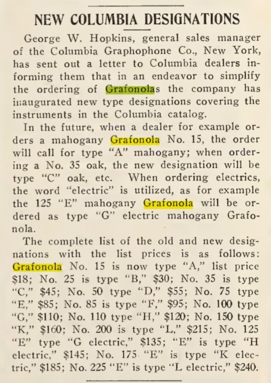

Apr 1918  Grafonola 50 renamed to type “D”  Attachment.
