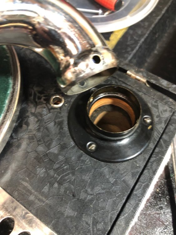

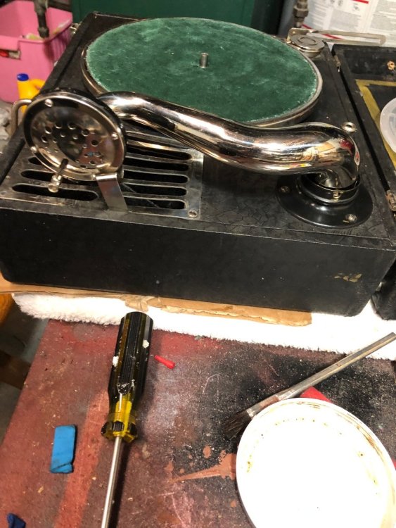

Good afternoon another question on this silvertone portable when I received it the tone arm came as seen on photos. When I try to play a record it slows down the turntable if I take a little pressure off the arm it plays . It looks like I might be missing a bushing or washer/ spacer on tone arm where it connects to player.

I can't tell if that's a 1-piece bracket.  If not, I suspect there should be a bolt that passes through the bracket and tone arm so that the latter can freely pivot vertically.  If, however, it's a 1-piece bracket, it looks like there's indeed something missing.

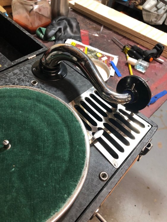

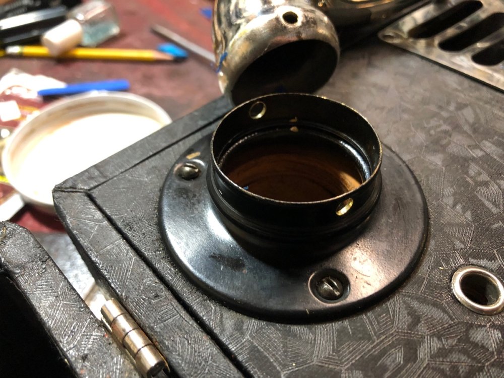

It didn’t have a bolt but I had one that fit I connected them but it’s very loose the arm moves smooth horizontally  but it also has a lot of vertical play . If I take pressure off the arm it will play.  ???? Maybe these pictures are better. Thanks again

1)  Does the bracket have a sleeve that rotates when the tone arm moves horizontally?
2) Are you using a fresh needle?
3) Have you tried different types of records?
4) Are you winding the motor all the way?
Yes the bracket has a sleeve the moves , it moves freely, I tried a different needle . I’ll try a different record. I wound it up until I I felt it tight. The platter spins easily, I can adjust the speed with regulator. Let me see what newer record and new needle will do Thanks.

Well George  I started from the beginning new needle, different record , cranked it complete and with a little adjustment with speed regulator and slight adjustment to angle of reproducer it is now playing . I also added some lubrication. Thanks again for sharing your wealth of knowledge . Im new to this hobby and appreciate all the help.
Dan
You're quite welcome, Dan.  With these machines, it's often a combination of elements that result in bad operation.  Sometimes when we think we've found the culprit and fixed it, performance improves only slightly.  Further painstaking examination/disassembly reveals something else...  But at a point, one little thing is fixed and VOILA!  Everything works!
If your "some lubrication" included the motor, consider "complete lubrication."  You may not need to disassemble and re-grease the mainspring, but all bearings and gear teeth need to be clean and properly lubricated.  The governor (especially the pad) is a critical component that requires good-quality sewing machine oil.  If you haven't already found it, here is one of the free articles on the APS website which may be helpful to you:
