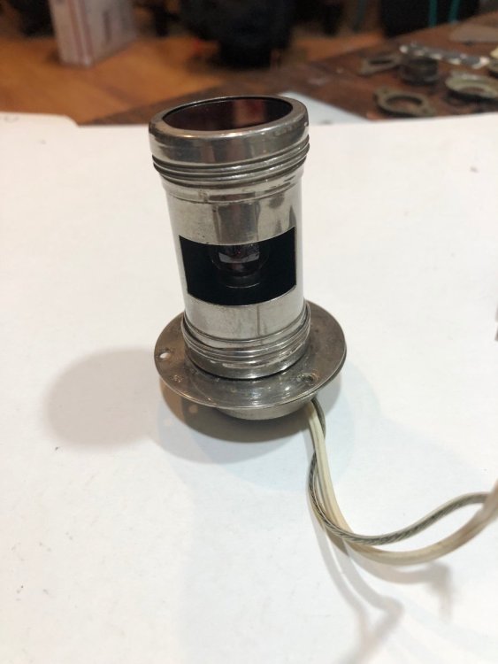

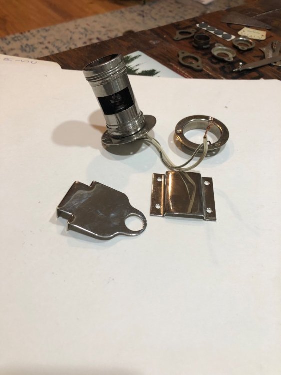

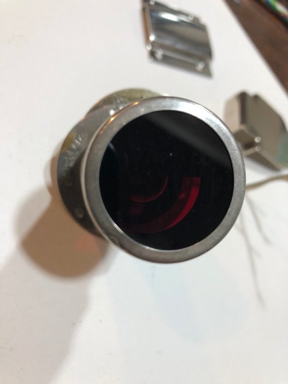

I got this on a lot of assorted antique phonograph parts? It says ever- ready , has small screw in bulb and a red lens on top . Not sure if the other parts go with it . Thanks
The device marked "Ever-ready" appears to be an accessory light to be mounted inside a phonograph's playing compartment.  These were offered in the late teens and 1920s for machines used in relatively dark environments (and who among us has never squinted while carefully lowering a needle onto the outer surface of a record?).
The two stamped metal pieces are part of an Edison horn crane; introduced in October 1907.

Thanks George , there are  a lot of parts , I didn’t need and don’t  know what they are  , but I liked this light Thanks
Dan
That is indeed an interesting light.  I don't recall ever seeing one with a colored lens in the top.
