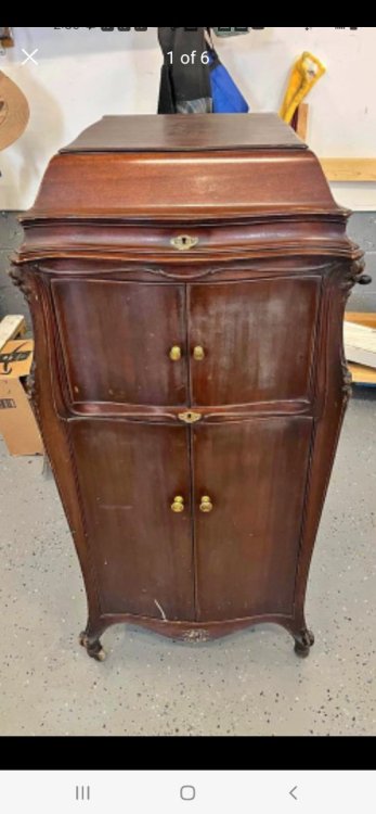

I'm going to be moving soon. I promised myself that I wasn't going to buy anything big till after the move. Well a great deal came up and I'm picking it up Sunday. Oh well there is always space for a little bit more lol
I also have a question does this model vv xvii have a 4 spring motor it

Yes I believe that will have that big  dual barrel quadruple spring motor.  I hope you back is good!
My brother is going to help me load it I was planning on going to a auction but this came up on facebook marketplace for 200 when I first sent a messaged about it he said someone was coming to buy it. A few hours later he messaged and asked if I was still interested evidently that person quit communicating. I haven't even seen it in person yet. Tommorow morning I'm picking it up.

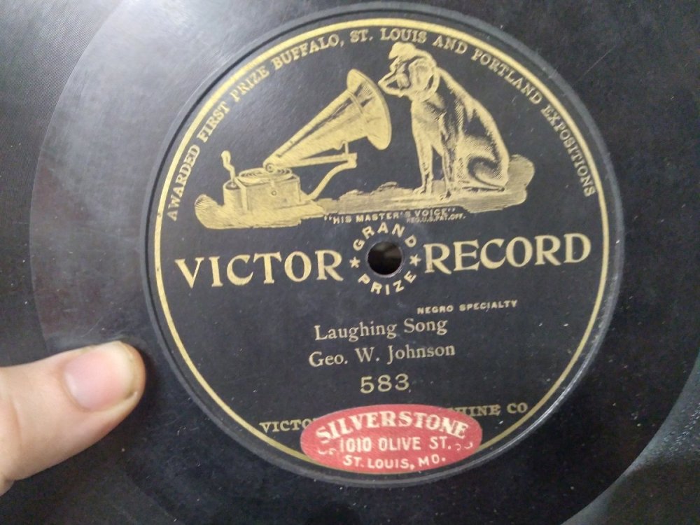

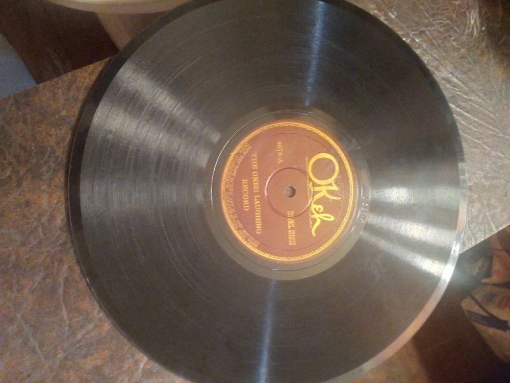

I picked it up earlier, there is all different types of interesting records in there lol

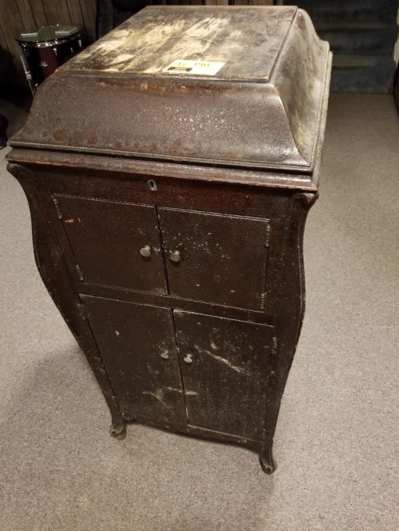

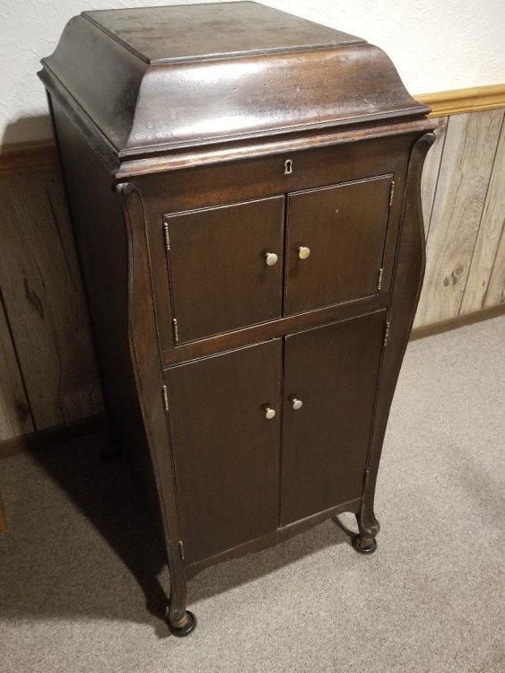

Looks like that will be very nice when cleaned up. Probably better than the VV-XI I brought home from an auction a couple months ago. 1446070934_VV-XIPre.thumb.jpg.21194adf32b735281362ef6a3e0976c9.jpg122001865_VV-XIcurrently.thumb.jpg.f1b9173e961958a09755f380ddba78b1.jpg

What did you use to clean the cabinet up. That is a big improvement. Nice job

This has the No 2 reproducer which was luckily in better shape than the cabinet. For the cabinet(which still needs a lot more work) I used Gojo hand cleaner and an old toothbrush to remove the many years of grime and then #0000 steel wool followed by some Feed-N-Wax. My goal is to keep this original. Won't look perfect but it will still be original.
