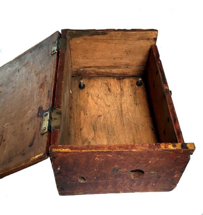

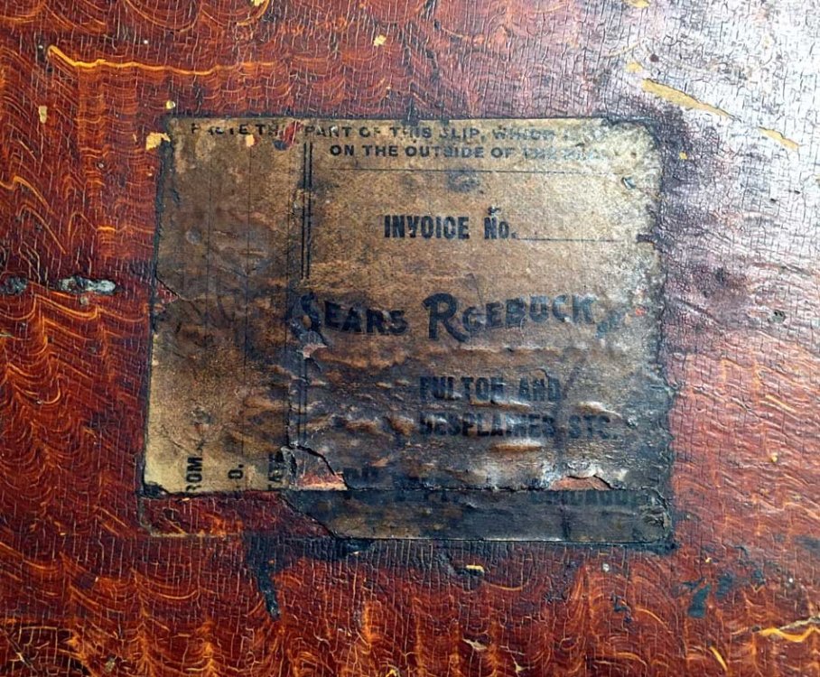

This is a one-of-a kind example of a cheap Graphophone in a homemade case made for use in public exhibitions. Although the lowly "Eagle" Graphophone was a much cheaper and more basic machine than those normally used for exhibitions, at least one company promoted them for the purpose: Sears Roebuck & Co. In the late 1890s the Sears catalog pushed the Eagle "at a price which brings them into the easy reach of those of small means, who wish to give public exhibitions... You can make $5 to $25 every evening by giving public exhibitions... by using hearing tubes and charging 5 cents for each individual."

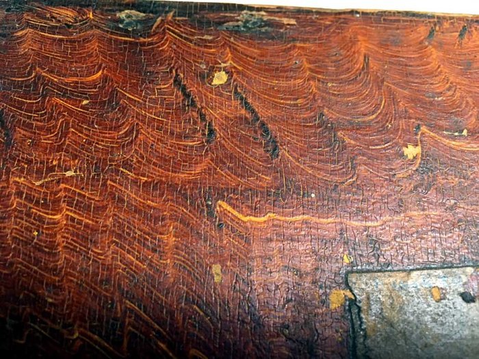

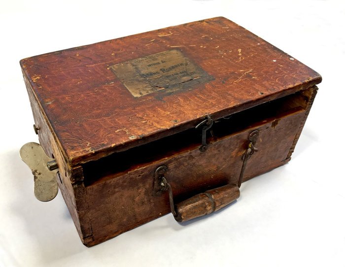

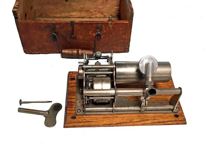

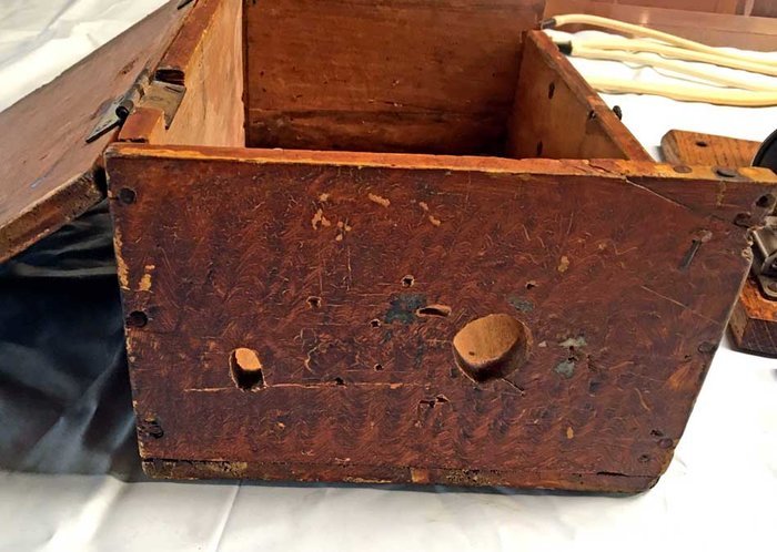

The Type B "Eagle" was sold starting in September 1897 at $10 uncased or $12 with the rounded lid as typically found. This is an example of the uncased style, with the serial number stamped onto the belt cover. The machine is mounted to a simple board with drilled corners and fitted inside a very crude homemade case made of rough pine. Curiously, the exterior was carefully painted to simulate expensive burled wood, as can be seen in the closeup photo below. The Graphophone is securely nestled inside, with holes in the base fitting over metal posts inside the case. An extra-long winding key and speed control extend through the left side, making it very convenient to carry about and operate. The holes on the side for the key and control are filed to a vertical oval shape. This allows the right end of the machine to be lifted up to remove and replace a cylinder, without having to take the machine out of the carrying case. The construction is crude, yet thought out.
It was likely used by a small-town exhibitor to cadge nickels from customers in saloons and general stores. Curiously, the box has a Sears invoice label glued on the top. I suspect that the original owner fabricated the carrying case using wood from the original shipping crate in which Sears packed the Graphophone. Why the maker glued a fake 'label' after painting it with faux grain will forever be a mystery. But it was deliberate: he varnished over it for protection. Perhaps it was to imply to viewers that it was a professional machine from a respected source, rather than a cheap, homemade unit?
